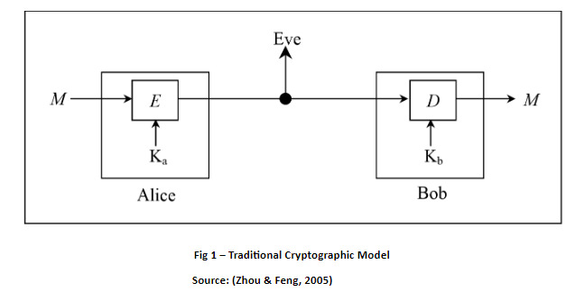

Whenever a discussion regarding Side Channel Attacks (SCA) is initiated, two models designed by (Zhou & Feng, 2005) are brought up. Below are the diagrammatic representations of both the models. The first model evaluates the foundation of the Cryptographic algorithms based on mathematical functions. In contrast, the second discusses how an attacker can benefit from all the leaked information when an algorithm is implemented on the hardware.
alt_text alt_text

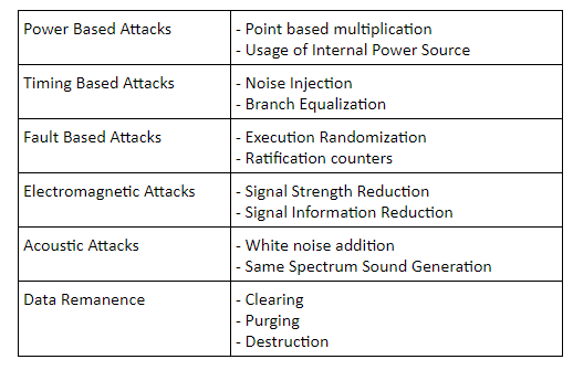

2. Countermeasures for known Side Channel Attacks The table below sums up the most used countermeasures for the popular types of SCAs.
alt_text alt_text
