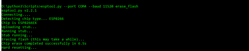

 Once its done it should look like this, then: >> We gotta install firmware on our node MCU>> Go to https://micropython.org/download site and download stable firmware, stable firmware best for the NOOBS like me :)>> then paste that file in the same directory D:Python3Scripts .>> Connect the Node MCU to the PC, note the COM port from devi manager.>> Then type following the cmd esptool.py --port COM4 --baud 11520 erase_flash to erase default LUA firmware.
 >> Now type following esptool.py --port COM4 --baud 11520 write_flash --flash_size= detect -fm dio 0 esp8266-20171101-v1.9.3.bin>> Note here you have to adjust your port number

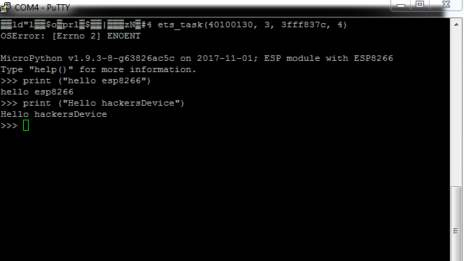

>> Now open putty and set serial baud rate is equal to 115200 and you can run the python commands on this
   So its done , We are ready to explore it , Happy hacking .....
